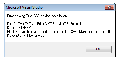

Faulty ESI file
If there is a faulty ESI file that cannot be read by the System Manager, the System Manager displays an information window.
Fig.66: Information window faulty ESI file (TwinCAT 3)This can be caused by
- Structure of the *.xml does not correspond to the associated *.xsd file → check your schematics
- Contents cannot be compiled into a device description → contact the file manufacturer

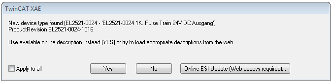

Online description
If the EtherCAT configuration is created online by scanning real existing devices (see chapter Online creation) and there is no ESI description available for a slave found (identified by name and revision), the System Manager asks whether it should use the description available in the device. The System Manager always requires this information in order to set the cyclical and acyclical communication with the slave correctly.
A window appears in TwinCAT 3 that also offers the web update:
Fig.67: OnlineDescription information window (TwinCAT 3)If possible, the Yes is to be rejected and the required ESI is to be requested from the device vendor. After installation of the XML/XSD file the configuration process should be repeated.

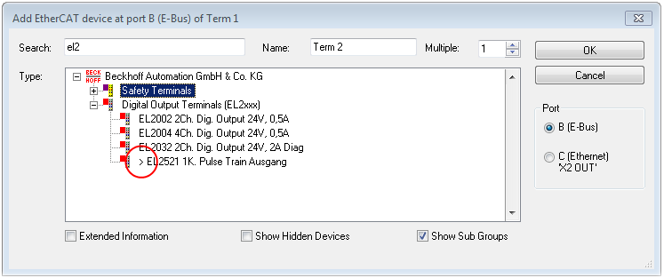

Fig.68: Created by the System Manager OnlineDescription.xmlIf a slave is then to be added manually to the configuration, slaves created "online" are identified by a preceding ">" symbol in the selection list (see figure Identification of an ESI recorded online using the EL2521 as an example).
Fig.69: Identification of an ESI recorded online using the EL2521 as an exampleIf such ESI files are used and the vendor's files become available later, the file OnlineDescription....xml should be deleted as follows:
