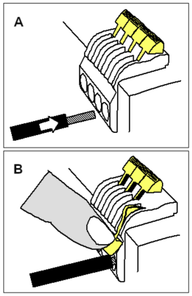

Terminals and wiring
The terminals are designed to be finger-safe according to IP20 and are suitable for field and factory wiring.
Technical data | Input | Output | EtherCAT |
Connection cross-section | e*: max. 6 mm² f*: max. 4 mm² a*: max. 4 mm² (d < 2.8 mm) | e*: max. 6 mm² f*: max. 4 mm² a*: max 4 mm² (d < 2.8 mm) | Bus interface: Data transfer medium: |
Connection cross section (AWG) | e*: AWG 20-10 f*: AWG 20-10 a* AWG 20-10 (d <2.8 mm) | e*: AWG 20-10 f*: AWG 20-10 a* AWG 20-10 (d<2.8 mm) | |
Strip length | 10 mm / 0.28 inch | 10 mm / 0.28 inch |
e* = single-wire, solid wire | f* = stranded wire | a* = with ferrule |
Wiring instructions:

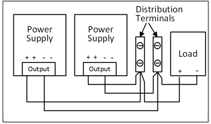

Series connection of power supply units
Series connection (looping from one power supply output to the next) is not allowed. Use a separate distribution terminal strip as shown in Fig. Using distribution terminals.
