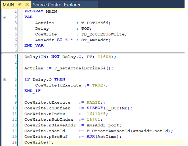

Update the time for the JSON file
The power supply has no information on the current local time. For this reason, the time of the events is always displayed as 0 by default.
The CoE object 0x10F9:01 can be used to inform the EtherCAT slave of the current time. The time of this object corresponds to the notation for 64-bit EtherCAT timestamps.
Theoretically, it is sufficient to transfer the current time once after switching on. The internal clock of the power supply unit is set and continues to run automatically. However, to ensure that the time of the master and the power supply unit do not drift apart, a regular update is recommended. (e.g. every minute).
Fig.138: Sample code for writing the time every minutePLC library:Tc3_JsonXml
