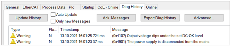

Display of errors and warning messages
Diag History
If a warning or error state is present and the warning or error bit has been set, the detailed warning or error messages can be read in the "Diag History" tab of the power supply (see also chapter "Complete Access to PSU Diag data"):
Display of errors and warning messages 1:Fig.125: Diag History tab with warning messages

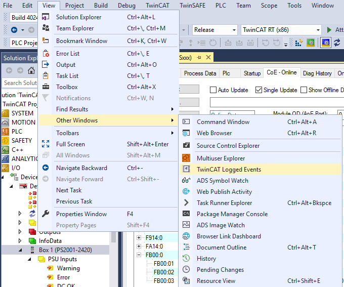

TwinCAT EventLogger
Alternatively, warnings and error messages are also displayed in the TwinCAT EventLogger.
Open the TwinCAT EventLogger via the "View" menu and select "Other Windows" -> TwinCAT Logged Events.
Display of errors and warning messages 2:Fig.126: Open TwinCAT EventLogger
