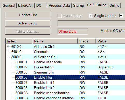

The CoE parameter directory (CanOpen-over-EtherCAT) is used to manage the set values for the slave concerned. Changes may, in some circumstances, have to be made here when commissioning a relatively complex EtherCAT Slave. It can be accessed through the TwinCAT System Manager, see Fig. EL3102, CoE directory:
 Fig.113: EL3102, CoE directory
Fig.113: EL3102, CoE directory |  | EtherCAT System Documentation The comprehensive description in the EtherCAT System Documentation (EtherCAT Basics --> CoE Interface) must be observed! |
A few brief extracts:
- Whether changes in the online directory are saved locally in the slave depends on the device. EL terminals (except the EL66xx) are able to save in this way.
- The user must manage the changes to the StartUp list.

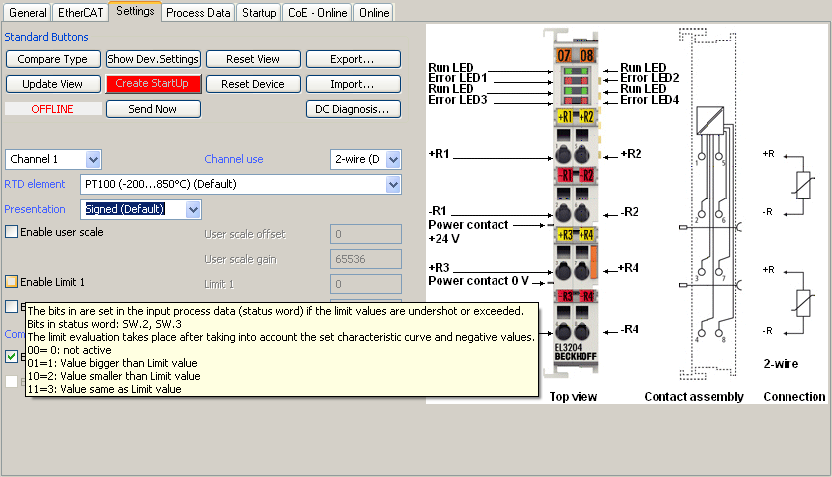

Commissioning aid in the TwinCAT System Manager
Commissioning interfaces are being introduced as part of an ongoing process for EL/EP EtherCAT devices. These are available in TwinCAT System Managers from TwinCAT 2.11R2 and above. They are integrated into the System Manager through appropriately extended ESI configuration files.
 Fig.114: Example of commissioning aid for a EL3204
Fig.114: Example of commissioning aid for a EL3204 This commissioning process simultaneously manages
- CoE Parameter Directory
- DC/FreeRun mode
- the available process data records (PDO)
Although the “Process Data”, “DC”, “Startup” and “CoE-Online” that used to be necessary for this are still displayed, it is recommended that, if the commissioning aid is used, the automatically generated settings are not changed by it.
The commissioning tool does not cover every possible application of an EL/EP device. If the available setting options are not adequate, the user can make the DC, PDO and CoE settings manually, as in the past.

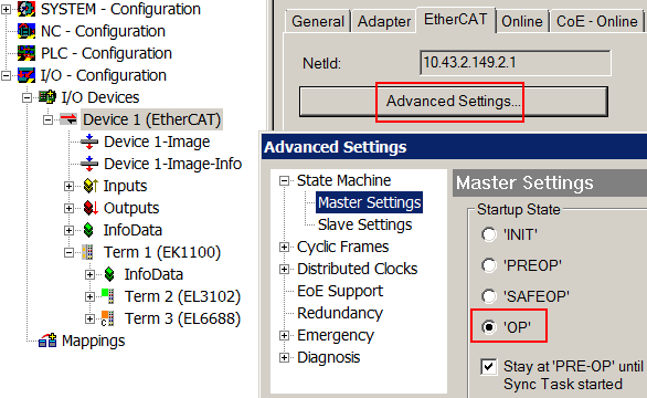

The target state wanted by the user, and which is brought about automatically at start-up by TwinCAT, can be set in the System Manager. As soon as TwinCAT reaches the status RUN, the TwinCAT EtherCAT Master will approach the target states.
Standard setting
The advanced settings of the EtherCAT Master are set as standard:
- EtherCAT Master: OP
- Slaves: OP
 This setting applies equally to all Slaves.
 Fig.115: Default behaviour of the System Manager
Fig.115: Default behaviour of the System ManagerIn addition, the target state of any particular Slave can be set in the “Advanced Settings” dialogue; the standard setting is again OP.

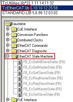

There are particular reasons why it may be appropriate to control the states from the application/task/PLC. For instance:
- for diagnostic reasons
- to induce a controlled restart of axes
- because a change in the times involved in starting is desirable
In that case it is appropriate in the PLC application to use the PLC function blocks from the TcEtherCAT.lib, which is available as standard, and to work through the states in a controlled manner using, for instance, FB_EcSetMasterState.
It is then useful to put the settings in the EtherCAT Master to INIT for master and slave.
