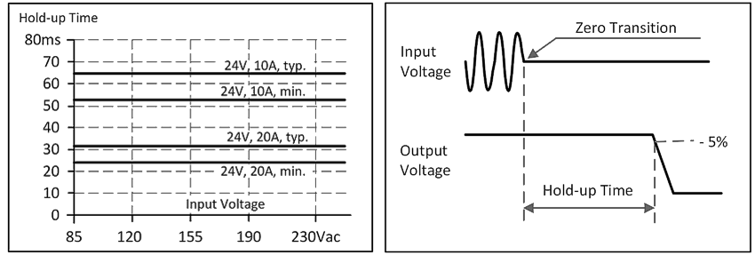

Hold-up time
The hold-up time is the time during which the output voltage of a power supply remains within the specification after a loss of input power. The hold-up time depends on the output load. Without load the hold-up time can be up to several seconds. The green DC-OK LED is also on during this time.
| AC 100 V | AC 120 V | AC 230 V |
Hold-up time | Typ. | 65 ms | 65 ms | 65 ms | At 24 V, 10 A, see Fig. Hold-up time vs. input voltage |
Min. | 54 ms | 54 ms | 54 ms | At 24 V, 10 A, see Fig. Hold-up time vs. input voltage | |
Typ. | 32 ms | 32 ms | 32 ms | At 24 V, 20 A, see Fig. Hold-up time vs. input voltage | |
Min. | 24 ms | 24 ms | 24 ms | At 24 V, 20 A, see Fig. Hold-up time vs. input voltage |
Fig.8: Hold-up time vs. input voltage; Shut-down behavior, definitions
