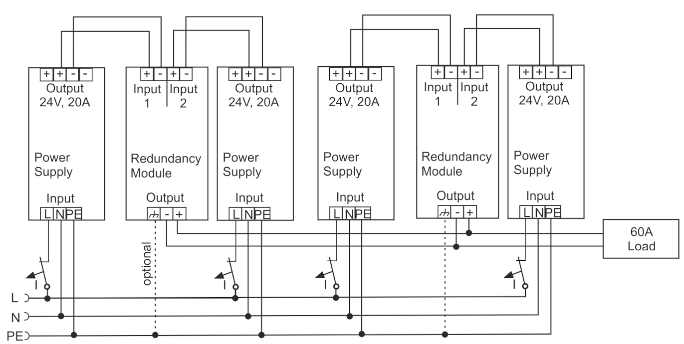

Notes on parallel use for N +1 redundancy
  • Note that leakage current, EMI, inrush current and harmonics increase when using multiple devices.
  • For N + 1 redundancy the ambient temperature is not allowed to exceed +60°C.
Redundant systems for a higher power demand are usually built in a N + 1 method. E.g. four devices, each rated for 20 A are paralleled to build a 60 A redundant system.
Wiring example:
N+1 Redundancy 2:Fig.24: Wiring for n+1 redundancy with two redundancy modules PS9401-2440-0000
