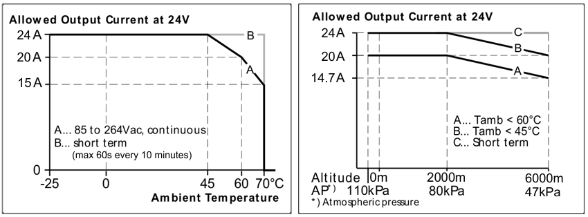

| Operating temperature 1) | -25°C to +70°C | Reduction of the output power according to Fig. Output current over ambient temperature |
| Storage temperature | -40°C to +85°C | For storage and transport |
| Output load reduction | 6.4W/°C 12W/°C | +45°C to +60°C / +60°C to +70°C |
| 1.33A/1000m or 5°C/1000m | For altitudes >2000m, see Fig. Output current over installation altitude | |
| The derating is not hardware-controlled. The user must take this into account in order to stay below the reduced current limits, so that device overload is avoided. | ||

| Atmospheric pressure | 110-47kPa | see Fig. Output current over installation altitude |
| Installation altitude | up to 6000m | see Fig. Output current over installation altitude |
