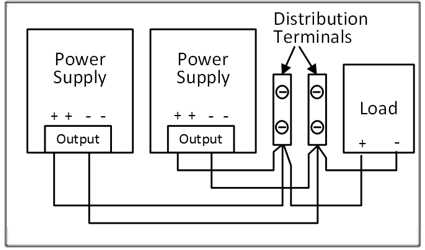

Series connection of power supply units:
Power supply units may be connected in series.
Please use a separate distribution terminal strip as shown in Fig. Use of distribution terminals.
