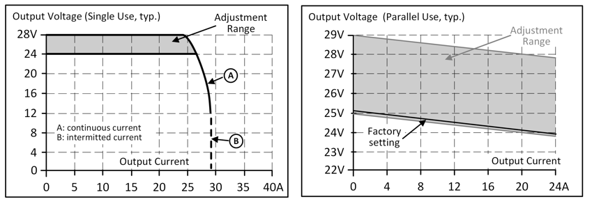

Between 0 and 20A, static value, "parallel use", see Fig. Output voltage over output current (parallel use) typ.

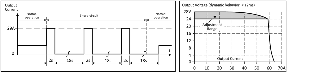

Up to 12ms once every five seconds, see Fig. Dynamic output current capacity, typ.
The fuse switch-off current is an increased transient current that contributes to the tripping of fuses on faulty output branches. The output voltage remains above 20V.
Overload behavior
Continuous current
Output voltage > 13Vdc, see Fig. Output voltage over output current, typ.
Hiccup mode2)
Output voltage < 13Vdc, see Fig. Output voltage over output current, typ.

Intermittent current peak value for typ. 2s
Load impedance 10mOhm, see Fig. Short circuit at the output,
The discharge current of the output capacitors is not included.
max
9.8A
RMS value of the current,

2) In the event of heavy overload (when the output voltage drops below 13V), the power supply provides continuous output current for 2s. The output is then switched off for about 18 seconds before a new switch-on attempt is automatically made. This cycle is repeated as long as the overload persists. After the overload has been rectified, the device will operate normally. See Fig. Short circuit at output, hiccup mode, typ.
Output 1:
Output voltage over output current (single use); output voltage over output current (parallel use)
Output 2:
Short circuit at output, hiccup mode, typ.; Dynamic output current capacity, typ.
