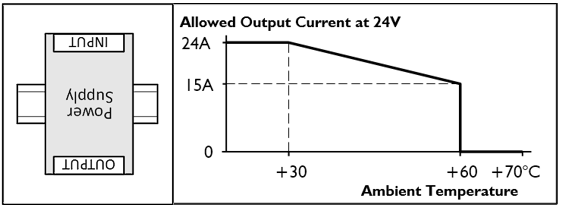

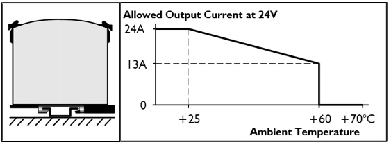

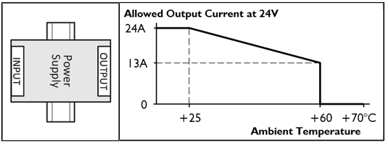

Installation positions
Installation positions other than the input connections at the bottom and the output at the top require a reduction of the continuous output power or a limitation of the maximum permissible ambient temperature.
The values for service life and MTBF given in this data sheet are only valid for the standard mounting orientation.
The following curves give an indication of permissible output currents for altitudes up to 2000m.
