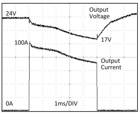

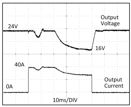

The additional current (peak current) is supplied by the power converter and the built-in large-size output capacitors of the power supply unit. The capacitors are discharged during such an event, which leads to a voltage drop at the output. The following two examples show typical voltage drops for ohmic loads:

| Peak current voltage drops | |
| Typically from 24V to 16V | At 40A for 50ms, ohmic load |
| Typically from 24V to 21V | At 100A for 2ms, ohmic load |
| Typically from 24V to 17V | At 100A for 5ms, ohmic load |
