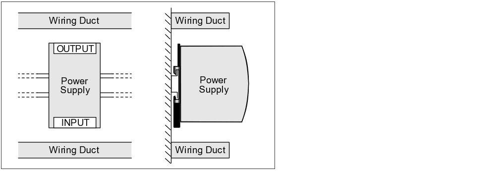

Installation positions
Install the device onto a DIN rail with the input terminals on the bottom of the device (see following fig. Mounting position A (Standard mounting position))
The test environment is set up installing wiring ducts with a depth of 80 mm with clearances seen in the following table.
Minimum installation clearances
Output power in relation to the nominal output
Minimum installation clearances (mm)
top
bottom
Left and right side
< 50%
40
20
0
≥ 50%
40
20
5
Installation positions 1:
