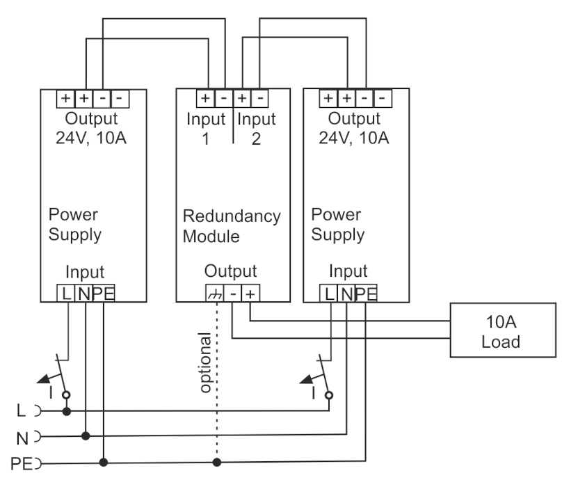

1+1 Redundancy
It is possible to connect power supplies in parallel for redundancy operation in order to achieve better system availability. Redundant systems provide a certain amount of additional power to operate the load when a power supply unit fails. The simplest method is to connect two power supplies in parallel. This is called 1+1 redundancy. If one power supply fails, the other can automatically supply the load current without interruption.
The 1+1 redundancy allows ambient temperatures up to +70°C.
![]()  | Notes on parallel use for 1+1 redundancy
Wiring example:
Fig.23: Wiring for 1+1 redundancy with a PS9401-2420-0000 redundancy module
