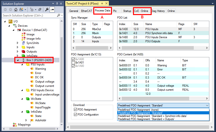

In the TwinCAT System Manager, a PS2001-xxxx-1001 power supply is parameterized via two dialog boxes/tabs.
- The Process Data tab (A) for the communication-specific settings only displays the process data.
- The CoE-Online tab (B) for settings in the slave contains all data exchanged via the EtherCAT interface.
- Changes to the process data-specific settings are generally only effective after a restart of the EtherCAT master:
restart TwinCAT in RUN or CONFIG mode; RELOAD in CONFIG mode - Changes in CoE - Online
- are in general immediately effective.
- are in general stored non-volatile only in the terminal/in the slave and should therefore be entered in the CoE StartUp list. This list is processed at each EtherCAT start and the settings are loaded into the slave.
- Observe the Notes for parameterization via the CoE directory.
