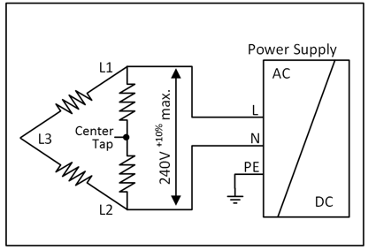

Operation on two phases
The power supply can also be used on two phases of a three-phase system. Such a phase-to-phase connection is permissible as long as the supply voltage is below 240V+10%.
Operation on two phases 1:
Make sure that the conductor connected to the N terminal is appropriately fused.
The maximum permissible voltage between a phase and the PE must be less than 300 Vac.
