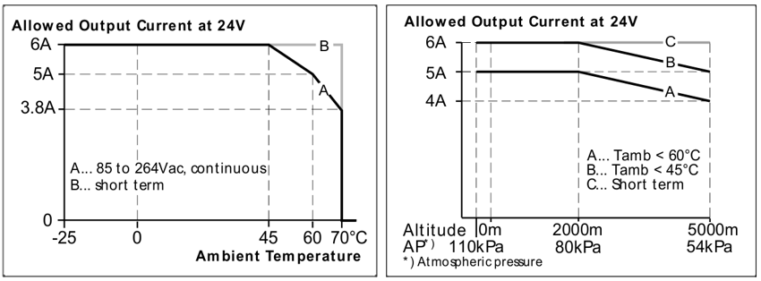

Operating temperature 1) | -25°C to +70°C | Reduction of the output power according to Fig. Output current over ambient temperature |
Storage temperature | -40°C to +85°C | For storage and transport |
Output load reduction | 1.6W/°C 3W/°C | +45°C to +60°C / +60°C to +70°C |
0.33A/1000m or 5°C/1000m | For altitudes >2000m (6560ft), see Fig. Output current over installation altitude | |
The derating is not hardware-controlled. The user must take this into account in order to stay below the reduced current limits, so that device overload is avoided. | ||

Atmospheric pressure | 110-54kPa | see Fig. Output current over installation altitude |
Installation altitude | up to 5000m | see Fig. Output current over installation altitude |

Fig.15: Output current over ambient temperature; output current over installation altitude
