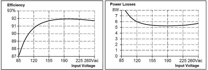

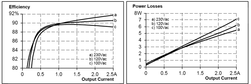

Efficiency and losses
| AC 100V | AC 120V | AC 230V |
Efficiency | typ. | 89.4% | 90.7% | 91.8% | At 24V, 2.5A, full load |
Average efficiency*) | typ. | 89.3% | 90.1% | 90.7% | 25% at 0.68A, 25% at 1.25A, |
Losses | typ. | 0.3W | 0.3W | 0.4W | At 24V, 0A (no load) |
typ. | 3.8W | 3.5W | 3.4W | At 24V, 1.25A (half load) | |
typ. | 7.1W | 6.2W | 5.4W | At 24V, 2.5A (full load) |
*) The average efficiency is based on assumptions for a typical application with the power supply unit operating at 25% of the nominal load during 25% of the time, 50% of the nominal load during 25% of the time, 75% of the nominal load during 25% of the time and 100% of the nominal load during the remaining time.
