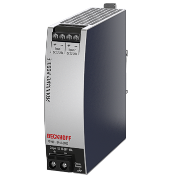

PS9401-2440-0000 – Redundancy Module
| The PS9401-2440-0000 is a redundancy module that can be used for the construction of 1+1 and N+1 redundancy systems. It has two input channels, to which power supplies with output currents of up to 20 A can be connected, and one output that can carry nominal currents of up to 40 A. The redundancy module uses MOSFET technology instead of diodes for decoupling the two input channels. This reduces the heat development and the voltage drop between input and output. Due to the low power loss, the device is very narrow and requires a width of just 36 mm on the DIN rail. Large connection terminals enable secure and fast installation. The redundancy module requires no additional auxiliary voltage. Due to the international approvals package, the device is suitable for virtually every application. Observe the connection instructions in the chapter "Parallel use for redundancy” |

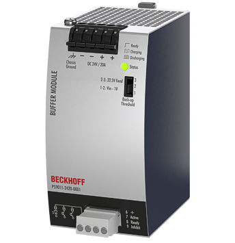

PS9011-2420-0001 – Buffer Module
| The PS9011-2420-0001 buffer module is an additional device for 24 V DC power supply units. It supplies power to bridge typical mains power failures or extends the hold-up time after switching off the AC voltage. If the power supply unit supplies sufficient voltage, the buffer module stores energy in the integrated electrolytic capacitors. In the event of a failure of the mains voltage, the stored energy is supplied to the DC bus in a controlled process. The buffer module can be connected at any point in parallel with the load circuit and does not require any control wiring. A buffer module can provide 20 A of additional power and can be added in parallel to increase the output current or hold-up time. The PS9011-2440-0000 buffer module can optionally be used to achieve longer hold-up times. |

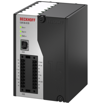

CU8130-0xxx – UPS component
| CU8130-0xxxs are battery-backed, uninterruptible power supplies (UPS). If the external 24 V DC input voltage is lost, the UPS takes over the supply of the devices connected to it thanks to its regulated and buffered 24 V DC output voltage. The CU81xx UPS series is suitable for all Beckhoff components, particularly Industrial PCs, Embedded PCs, Panels and Panel PCs. The main features of this UPS are:
A special feature of the Beckhoff CU81xx devices is OCT (One Cable Technology) as communication technology between UPS and Industrial PC. This means that the two connecting lines (+24 V, 0 V) between Industrial PC and UPS are used not only to supply the Industrial PC, but also for bidirectional data transmission. If both sides are OCT-capable, no further connection, e.g., via USB, is required. Further information on UPS components can be found on the Beckhoff homepage. |
