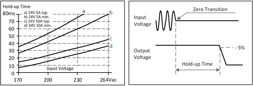

Hold-up time
The hold-up time is the time during which the output voltage of a power supply unit remains within the specification after a loss of input power. The hold-up time depends on the output load. Without load the hold-up time can be several seconds. The green DC-OK LED also lights up during this time.
| 230 Vac |
Hold-up time | Typ. | 75 ms | At 24 V, 5 A, see Fig. Hold-up time over input voltage |
Min. | 59 ms | At 24 V, 5 A, see Fig. Hold-up time over input voltage | |
Typ. | 33 ms | At 24 V, 10 A, see Fig. Hold-up time over input voltage | |
Min. | 25 ms | At 24 V, 10 A, see Fig. Hold-up time over input voltage |
Fig.5: Hold-up time over input voltage; switch-off behavior, definitions
