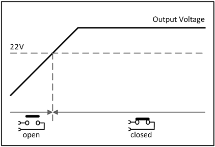

This function monitors the output voltage generated by the power supply itself.
The contact closes  | when the output voltage reaches 22 V.  |
The contact opens  | as soon as the output voltage falls below 22 V.  |
Switching hysteresis  | typ. 0.7 V  |
Contact load capacity  | Maximum 60 Vdc 0.3 A, 30 Vdc 1 A, 30 Vac 0.5 A, ohmic load  |
Minimum permissible load: 1 mA at 5 Vdc  | |
Insulation voltage  | see the table in chapter Dielectric strength  |
Fig.6: Behavior of the DC-OK relay contact
