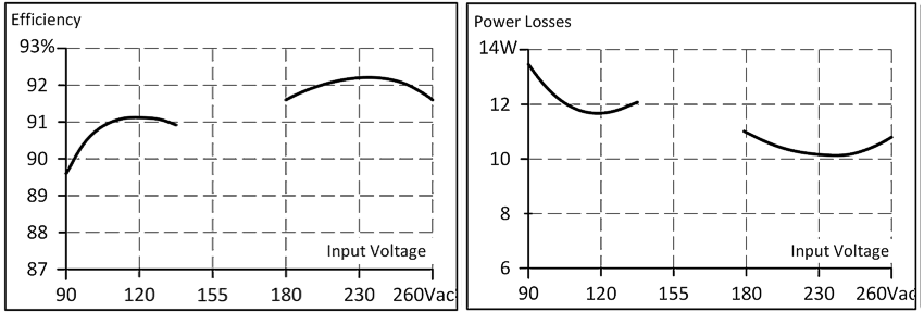

Efficiency and losses
| AC 100V | AC 120V | AC 230V |
Efficiency | Typ. | 90.7% | 91.2% | 92.3% | At 24 V, 5 A |
Average efficiency*) | Typ. | 89.2% | 89.4% | 90.6% | 25% at 1.25A, 25% at 2.5A, |
Losses | Typ. | 1.4W | 1.5W | 0.7W | At 24 V, 0 A |
Typ. | 7.0W | 7.4W | 6.0W | At 24 V, 2.5 A | |
Typ. | 12.3W | 11.6W | 10.0W | At 24 V, 5 A |
*) The average efficiency is based on assumptions for a typical application with the power supply unit operating at 25% of the nominal load during 25% of the time, 50% of the nominal load during 25% of the time, 75% of the nominal load during 25% of the time and 100% of the nominal load during the remaining time.
