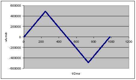

Limiting by acceleration
Dynamic characteristic quantities applied:
a_max: 1000mm/s2
v_max: 5000000um/s
%L sub_mv
N1000 G01 G90 Y100 F500
N2000 Y-100
M29
%osc_7
N10 X[OSC ON 1ST_POS= 120 2ND_POS=120 FREQ=0.6]
N20 LL sub_mv
N30 X[OSC OFF]
N180 M30
Limiting by acceleration 1:
Figure 1-5: Limited oscillation frequency due to axis acceleration
A time of 1.964s is needed for one full oscillation. The required 1.666s (approx. 833 cycles) due to the oscillation frequency of 0.6Hz is therefore not possible with the dynamic characteristic quantities mentioned above.
