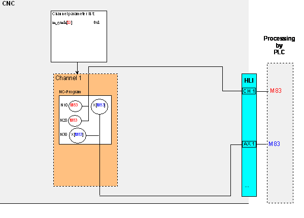

Example 1
It should be optionally possible to output the M function to the channel or the X axis. Synchronization is not necessary.
Channel parameter list
m_synch[83] 0x1
Programming example
N10 M83 X[M83]
N20 M83
N30 X[M83]
