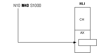

Output always takes place in the spindle-specific range, and the PLC_INFO bit is not used here.
Possible:
- Output to other axes by axis-specific programming (e.g. X[M40]). The gear change function is then not active.
Not possible:
- Output to a spindle by axis-specific programming
- A default output to axes or spindles (Channel parameters).
