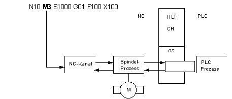

Example 1b: CNC spindle, synchronized internally and by the PLC
To achieve output of the M functions to the PLC, the PLC_INFO bit is set in the synchronization mode.
The spindle always executes the corresponding command immediately (asynchronously). Corresponding to the synchronization method, the contouring motion however is additionally synchronized with the acknowledgement by the PLC.
