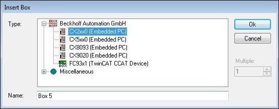

3. Select the appropriate box, e.g. the CX2xx0 (Embedded PC) if you use a CX20xx Embedded PC with optional PROFINET interface.
Creating a virtual slave 2:
