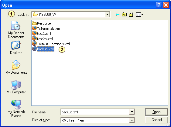

step 2: The following window will open.
  1. Select the folder where you have saved your configuration file.
  2. Select the configuration file. (e.g. Backup.xml)
  3. Click Open (Öffnen).

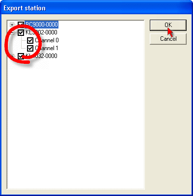

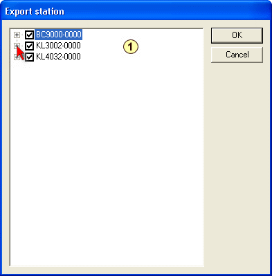

step 3: The following window will open. If you click onto the "+" more selections are possible. Please have a look onto the next picture to get an better idea.
How to restore a terminal station? 3:
By selecting or deselecting the box you can decide, which information is getting saved. When your selection is finished click OK.
