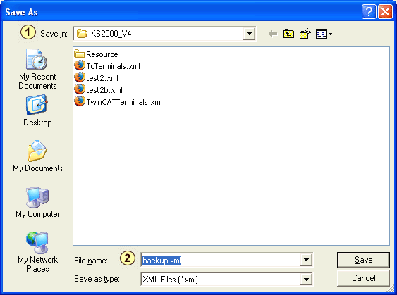

How to save a terminal station? 1:
step 2: The following window will open.
  1. You can change the target folder if you want to.
  2. Change the file name into a suitable name, which makes it easier for you to bring the file in relation to the hardware you want to save.
  3. Click Save (Speichern).

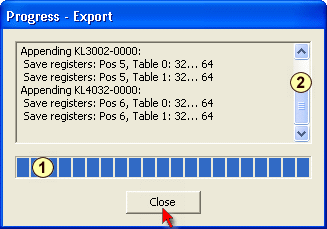

How to save a terminal station? 2:
step 3 : Now the export process starts.
  1. Shows you the progress status. During the export progress the Close Button is blanked out.
  2. With the scoll bar you can scroll through the protocoll.
When you are finished click Close to close the window.
