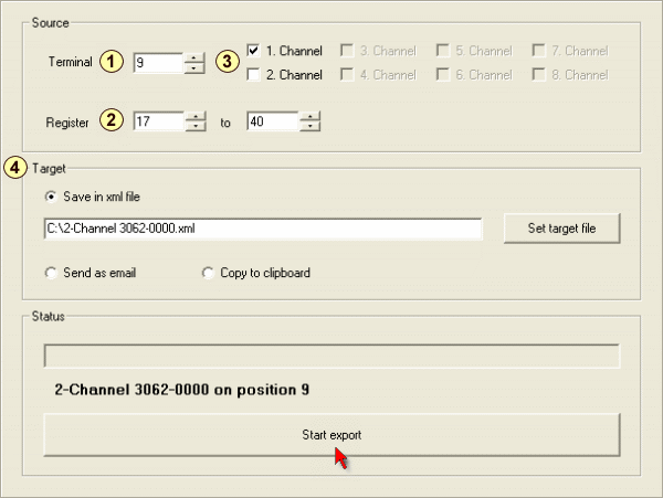

step 1: click onto Reports - Terminal:Register Documentation
How to export a terminal script? 1:
step 2: with the up/down button you can choose the Terminal you want to save
step 3: tick the Channel you want to save
step 4: with the up/down button you can choose the beginning and ending of the Register you want to save
step 5: with a tick you can choose the Target where you want to save the file to
step 6: click Start export

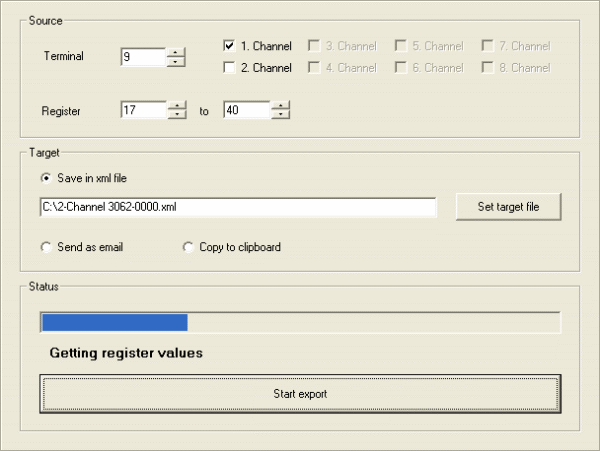

How to export a terminal script? 2:
Notice
Wait for the process to finish
Wait until the process has finished before starting something else.
