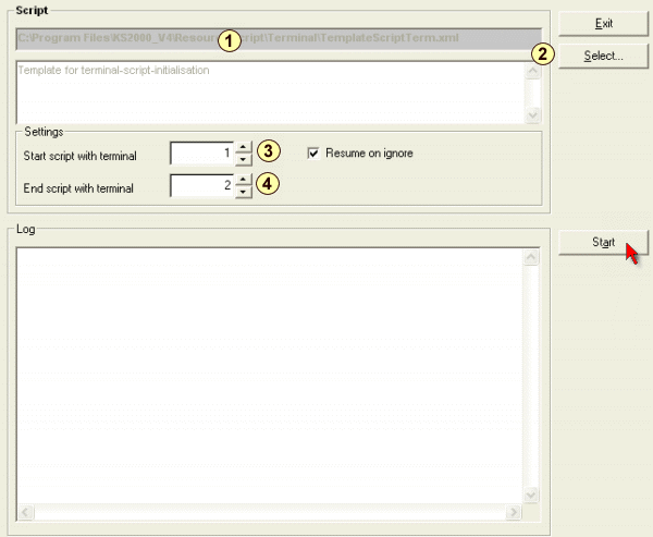

step 1: click Online
step 2: hover onto Terminal and click Script-Init...
How to write a script into a terminal? 1:

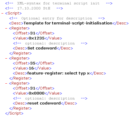

step 3: choose a script file and click open (öffnen). (example file: TemplateScriptTerm.xml)
How to write a script into a terminal? 2:
step 4: the following menu will appear. If you have chosen the wrong file (1) click Select... (2)
step 5: choose the start (3) and the end (4) terminal where the script should be written in.
step 6: click start
How to write a script into a terminal? 3:
step 6: Click Exit to leave the menu.

For definition of  the schema of script-file for terminals see sample file under "...\KS2000\Resource\Scripts\Coupler\TemplateScriptTerm.xml"
