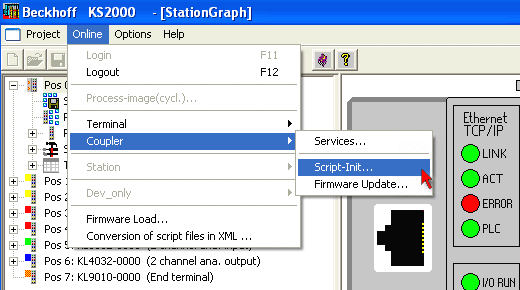

step 1: click Online
step 2: hover onto Coupler and click Script-Init...

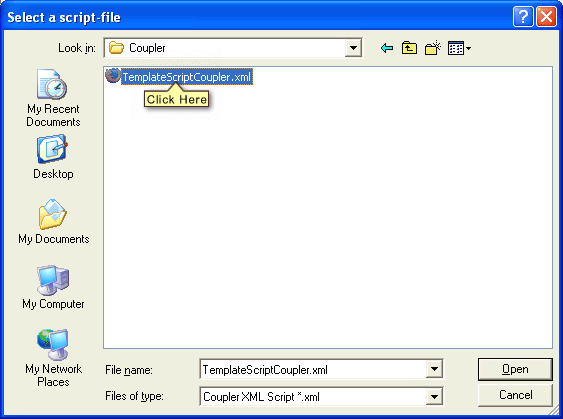

step 3: choose a script file and click open (öffnen). (example file: TemplateScriptCoupler.xml)

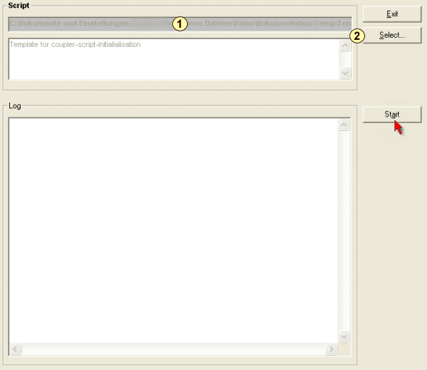

step 4: the following menu will appear. If you have chosen the wrong file (1) click Select... (2)
step 5: click start
How to write a script into a coupler or controller? 3:

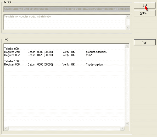

step 5: the process is completed. click OK (JA)
How to write a script into a coupler or controller? 4:
step 6: Click Exit to leave the menu.
How to write a script into a coupler or controller? 5:
How to write a script into a coupler or controller? 6:
Devices require reboot to enable new settings, so please power cycle the station.

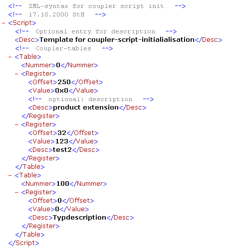

For definition of  the schema of script-file for buscontrollers and buscouplers see sample file under "...\KS2000\Resource\Scripts\Coupler\TemplateScriptCoupler.xml"
