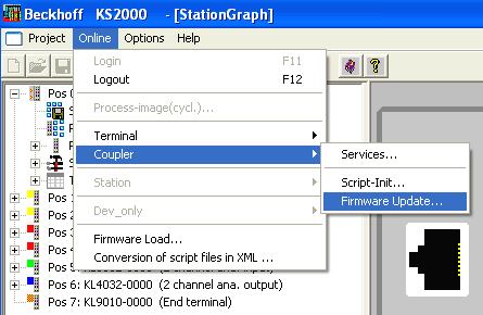

step 1: click Online.
step 2: hover onto Coupler and click Firmware Update...
How to do a coupler software update? 1:

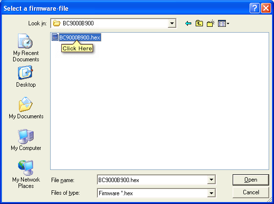

step 3: choose the file and click open (öffnen). (example filename: BC9000B900.hex)
How to do a coupler software update? 2:

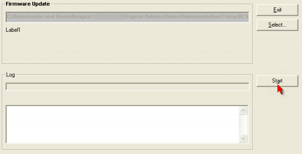

step 4: The following menu will appear. If you have chosen the wrong file click Select... otherwise click Start.
How to do a coupler software update? 3:

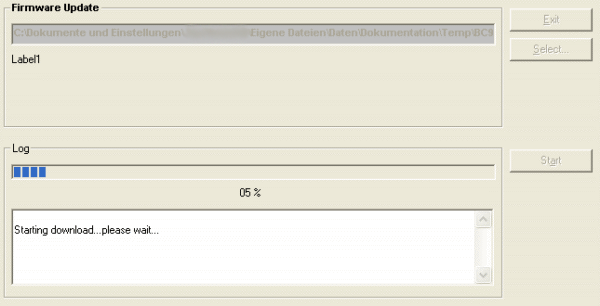

Don't do anything while the update process is running.
How to do a coupler software update? 4:

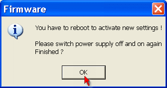

step 5: the update process is completed. click OK
How to do a coupler software update? 5:
