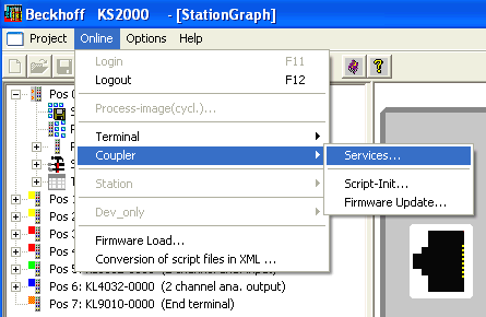

About the Coupler service menu 2:
step 1: click on Online in the menu bar.
step 2: hover onto Coupler and click Services.
About the Coupler service menu 3:

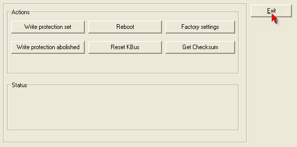

Coupler Service menu:
About the Coupler service menu 4:
Write protection set: enables the write protection of the coupler
Write protection abolished: disables the write protection of the coupler
Reset KBus: does a K-bus reset
Factory settings: does a software reset to default settings
Get Checksum: does a checksum test
Reboot: does a hardware reset and reboot
Click Exit to leave the coupler service menu.
