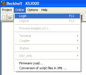

step 1: click on Online in the menu bar.
step 2: click Login.

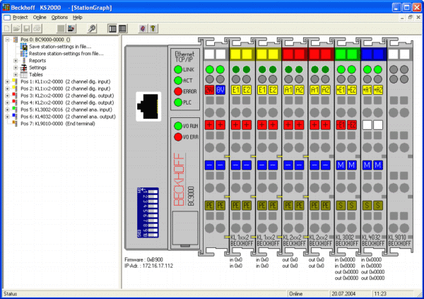

Example with BC/BK
How to get online and offline? 5:Fig.27: Online screen when a BC/BK with bus terminals is connected

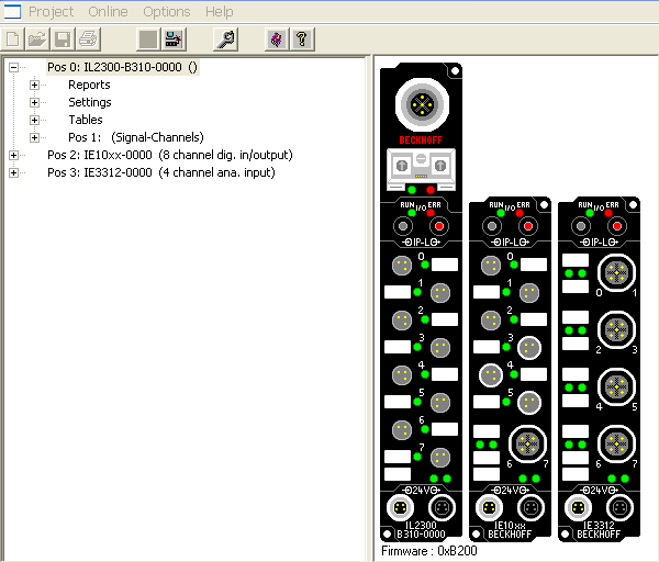

Example with fieldbus box
How to get online and offline? 6:Fig.28: Online screen when a fieldbus box is connected

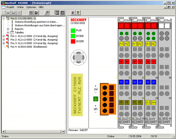

Example with CX
How to get online and offline? 7:Fig.29: Online screen when a CX is connected

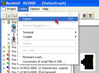

step 2: click Logout.
