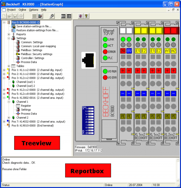

To make it easier to navigate you can activate or deactivate the views Treeview and Reportbox.
How to do the view settings? 1:
There are two ways of changing the views

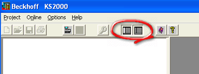

Select from the tool bar the view buttons.
How to do the view settings? 2:
click onto the buttons to activate or deactivate the view.

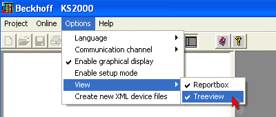

step 1: click onto Options in the menu bar.
step 2: Then hover onto View and click onto the view you want to activate or deactivate.
