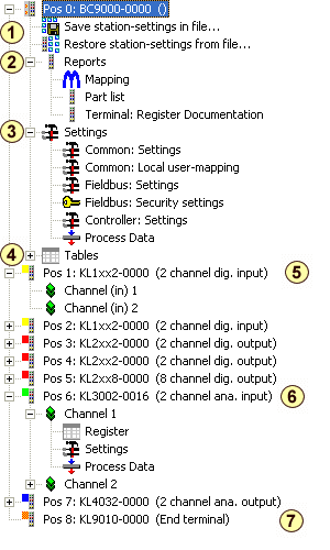

Bus Terminal
Control and configuration menu 1:
  1. Save station-settings in file... / Restore station-settings from file...:
    With these two functions you can save and restore the station your are connected to.
  2. Reports:
    This function provides you general information about a terminal station.
    • click mapping and you get the information about the I/O address and bit size of the connected terminals
    • click pice list and you get the information about the position and number of the connected parts
    • click Terminal: Register Documentation to save the register of a terminal into a script file
  3. Settings:
    This function provides you general information about the settings of a terminal station.
    • click Common: Settings to do the settings for the K-bus, SPS Interface and the Process Data 1 - 4
    • click Common: Local user-mapping to define the specific sequence of your connected terminals
    • click Fieldbus: Settings to do the specific fieldbus configuration.
    • click Controller: Settings to do the specific controller configuration (only available when a controller is connected)
    • click Process Data to do a direct configuration of your K-bus I/O process image
  4. Tables:
    If you want to configure a terminal station directly and without menues, then click tables and a list of different tables will appear. Select the table you want to change and type in the information.
    This function should be used only from advanced users!
  5. digital Terminals:
    From here all digital terminals are listed.
    • click Channel and you will get detailed information about the process
  6. analog Terminals:
    From here all analog terminals are listed.
    • click Register to do a direct configuration in the register of the terminal
    • click Settings to do a general configuration of the terminal
    • click Process Data and you will get detailed information about the process.
  7. End terminal

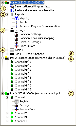

Fieldbus Box
Control and configuration menu 2:
  2. Reports:
    This function provides you general information about the fieldbus box.
  3. Settings:
    This function provides you general information about the settings of the fieldbus box.
    • click Common: Local user-mapping to define the specific sequence of your connected extension boxes
  4. Tables:
    If you want to configure a Fieldbus Box directly and without menues, then click tables and a list of different tables will appear. Select the table you want to change and type in the information.
  5. Signal-Channels: I/Os of the (compact, coupler, plc) box
  6. digital extension boxes:
    From here all digital extension boxes are listed.
  7. analog extension boxes:
