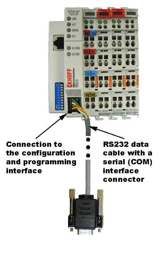

Bus Coupler and Bus Terminal Controller

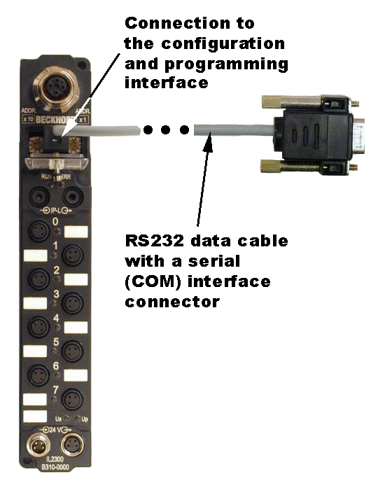

How to connect a Bus Terminal or Fieldbus Box to a computer? 2:Fig.19: Connection of Bus Coupler and Bus Terminal Controller
Fieldbus Box Modules
How to connect a Bus Terminal or Fieldbus Box to a computer? 3:Fig.20: Connection of Fieldbus Box Modules
