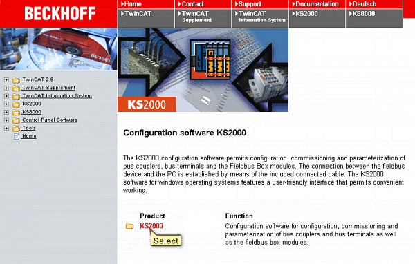

step 1: Insert the KS2000 software CD-ROM into your CD-ROM drive. When the KS2000 menu appears, click KS2000.
How to install the KS2000 software? 1:

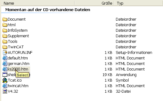

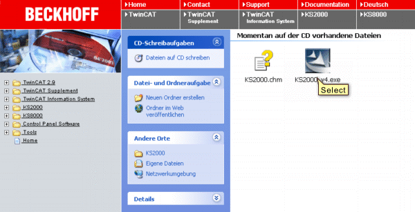

If the program does not start automatically, start the windows explorer, and select the CD-ROM drive. Then double-click ks2000.htm.
How to install the KS2000 software? 2:
step 2: double-click KS2000_v4.exe
How to install the KS2000 software? 3:

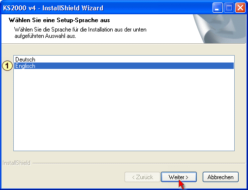

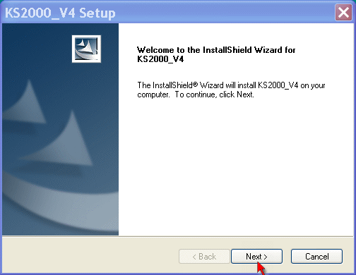

step 3: Select the language of the InstallShield Wizard and click Next (Weiter).
How to install the KS2000 software? 4:

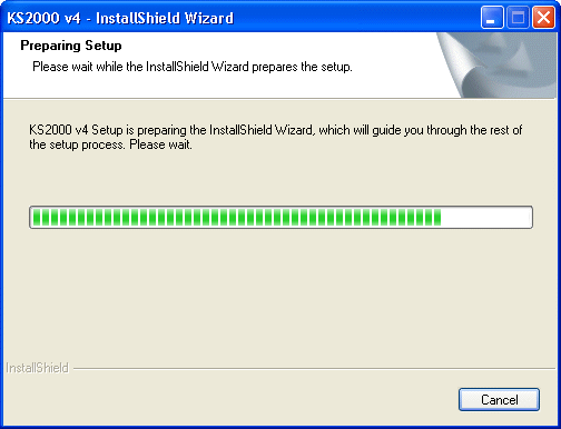

The following window will appear.
How to install the KS2000 software? 5:
step 4: Follow the on-screen instructions to complete the setup. When the InstallShield Wizard runs, click Next
How to install the KS2000 software? 6:

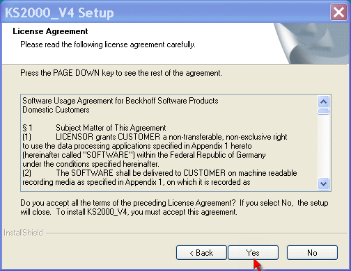

step 5: Read and confirm End User License Agreement and click Yes.
How to install the KS2000 software? 7:

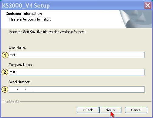

step 6: Type in your User Name, the Company Name and the Serial Number. The Serial Number you will find on the cover of your KS2000 software CD-ROM. After you finished click Next.
How to install the KS2000 software? 8:

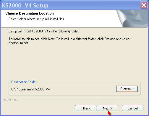

step 7: Choose a folder to install the KS2000 software. It is recommended to select the default folder. If you want to install the software in a different folder, click Browse and select the folder you want. Click Next.
How to install the KS2000 software? 9:

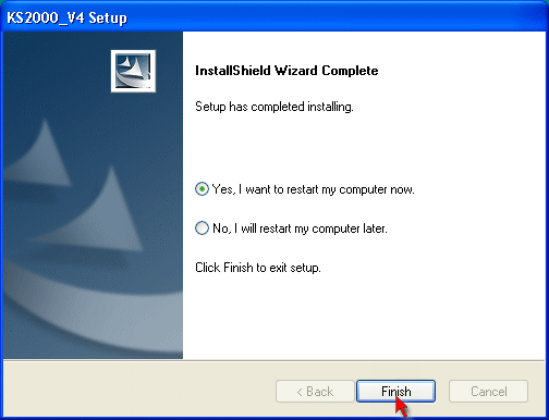

step 9: The installation process is complete. Select Yes, I want to restart my computer now when you want to use the KS2000. Before you click Finish, make sure that all open files are saved because your system is getting rebooted.
How to install the KS2000 software? 11:
