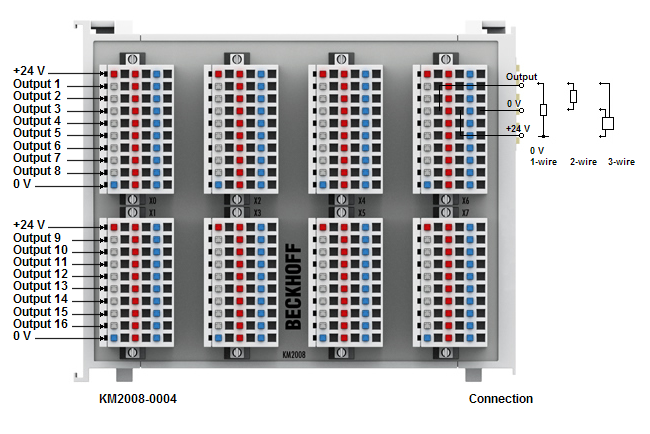

Digital Terminal Modules with 64 output channels
Digital Terminal Modules with 64 output channels (24 VDC)
The terminal module KM2008 combines 64 digital outputs with 8 channels per plug connector in a compact design with high packing density. The binary control signals are transferred (electrically isolated) to the actuators at the process level. Like the standard Bus Terminals, the terminal modules are integrated in the I/O system. Plug connectors with spring connections enable plug-in wiring and are available with 1 or 3 pins. LEDs integrated in the connector indicate the signal state for each channel directly at the wire. The outputs are protected against overload and short circuit.
