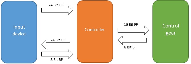

With regard to the communication, a distinction is made between three telegram types:
- 16-bit query, configuration and control telegram.
- 24-bit query, configuration and control telegram.
- 24-bit event telegram.
BF: backward frame
FF: forward frame
16-bit telegrams
16-bit telegrams are always sent from a DALI controller to a DALI control gear. They are used for configuring the devices, querying parameters or sending control commands. For certain DALI commands the DALI control gear sends an 8-bit response. DALI control gears only send an 8-bit telegram when requested.
In the Tc3_DALI library these commands are identified by the PLC function blocks with the prefix FB_DALI102 or FB_DALI2xx, e.g. FB_DALI102QueryActualLevel or FB_DALI207QueryFeatures.
24-bit telegrams
24-bit telegrams are always sent from a DALI controller to a DALI control device. They are used for configuring the devices, querying parameters or sending control commands. For certain DALI commands the DALI control device sends an 8-bit response.
In the Tc3_DALI library these commands are identified by the PLC function blocks with the prefix FB_DALI103 or FB_DALI3xx, e.g. FB_DALI103QueryOperatingMode or FB_DALI303SetHoldTimer.
24-bit events
DALI control devices are able to send events. They are always evaluated by the DALI controller and have a length of 24 bits.
Individual events can be filtered out and further processed with the function blocks FB_DALIGetInputNotification and FB_DALIGetPowerCycleNotification.
