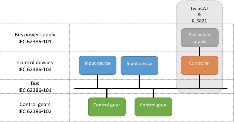

The IEC 62386-101, IEC 62386-102 and IEC 62386-103 standards describe general properties, while the IEC 62386-2xx and IEC 62386-3xx standards specify the individual device types. IEC 62386-103 and IEC 62386-3xx were included in Revision 2 of the DALI standard.
IEC 62386 1:
Up to 64 DALI control gears and up to 64 DALI control devices can be connected to the KL6821 per DALI line. The KL6821 represents the DALI controller. One such device exists for each DALI line. Up to 64 control gears, which have to be DALI/DSI devices, can be connected to the KL6811. Any number of DALI lines (KL6821 and KL6811) can be operated with a single TwinCAT controller.
