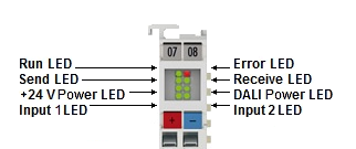

LED displays
LED | Color | State | Meaning |
RUN | green | on | Data transmission on the K-bus |
Error | Red | on | No 24 VDC power supply at contact 1 and 5 or hardware error |
Send | green | flashes | A DALI telegram is sent every time the light came on |
Receive | green | flashes | A DALI telegram was received each time the light came on |
+24 V Power | green | off | No 24 VDC power supply at contact 1 and 5 |
on | 24 VDC power supply at contact 1 and 5 okay | ||
DALI Power | green | off | Integrated DALI power supply switched off |
on | Terminal supplies the DALI bus with voltage | ||
Input 1 | green | off | DI 1 is switched off |
on | DI 1 is switched on or was active and has not yet been acknowledged | ||
Input 2
| green | off | DI 2 is switched off |
on | DI 2 is switched on or was active and has not yet been acknowledged |
