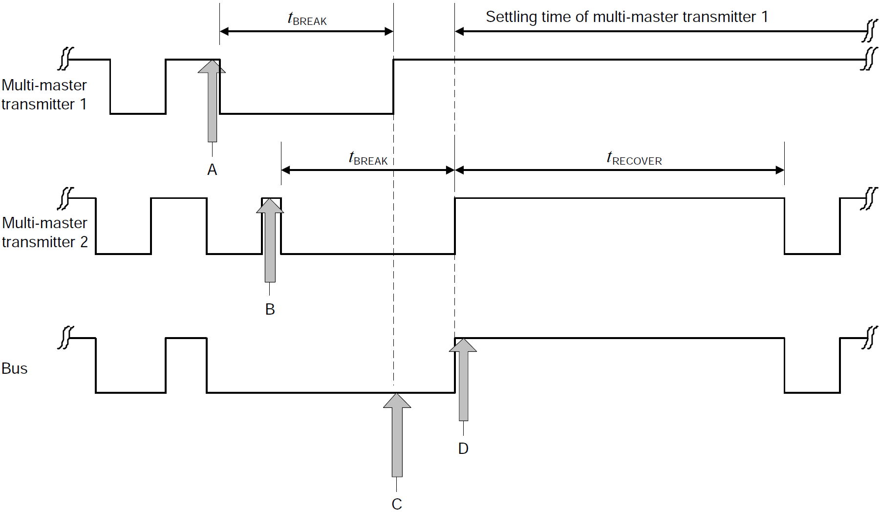

The following diagram explains the collision resolution.
If several DALI devices send a high level, this cannot be detected by the DALI devices. The resulting voltage on the DALI bus is also a high level in this case.
At point A DALI device 1 detects a collision, because an attempt is made to generate a high signal at this point, but the DALI bus is pulled to low level by DALI device 2. DALI device 1 starts the break sequence for this reason. During this time the DALI device pulls the DALI bus to low level.
At point B DALI device 2 tries to generate a high level. However, since the DALI bus is pulled to low level by DALI device 1, DALI device 2 also detects a collision and also starts the break sequence.
At point C the break sequence of DALI device 1 has expired. Subsequently, it is checked whether the DALI bus is still at low level. Since this is the case, the system waits until the DALI bus is free again. DALI device 1 then starts sending the DALI telegram again, including the settling time.
If the break sequence is finished at DALI device 2, the DALI bus is not occupied by any other DALI device (point D). Therefore the recover sequence is started at DALI device 2 and then the DALI telegram is sent again directly (without settling time).
Collision detection 1:
The break sequence has a length of 1.2 ms to 1.4 ms, while the recover sequence can be between 4.0 ms and 4.6 ms.
