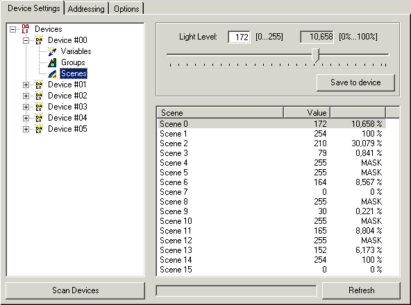

Scenes
The light intensities for 16 different scenes can be stored at each DALI device through this mask. If a DALI device receives a scene number for which it has been parameterized (e.g. in the context of a broadcast), it will set the intensity specified for this scene. If the value 255 (mask) is specified for this scene, the DALI device retains its previous value.
Scenes 1:Fig.23: KS2000 - parameterization of the DALI/DSI devices - scenes
