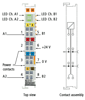

KL5152/KS5152 (KL5151-0050) - Contact assignment
Terminal point | No. | In the encoder interface operating mode* | In the counter operating mode* |
A1 | 1 | Input A for encoder 1 | Counter input |
+24 V | 2 | Power contact +24 V (internally connected to terminal point 6) | |
0 V | 3 | Power contact 0 V (internally connected to terminal point 7) | |
A2 | 4 | Input A for encoder 2 | Counter enable (gate input for the counter operating mode) |
B1 | 5 | Input B for encoder 1 | Counting direction: |
+24 V | 6 | Power contact +24 V (internally connected to terminal point 2) | |
0 V | 7 | Power contact 0 V (internally connected to terminal point 3) | |
B2 | 8 | Input B for encoder 2 | no function |
*) The operating mode is set with bit R32.15 of the feature register.
KL5152/KS5152 (KL5151-0050) - LED indicators
Signal LED | Function | Encoder |
Ch. A1 | Lights up when a signal is present at input A1. | 1 |
Ch. B1 | Lights up when a signal is present at input B1. | |
Ch. A2 | Lights up when a signal is present at input A2. | 2 |
Ch. B2 | Lights up when a signal is present at input B2. |
