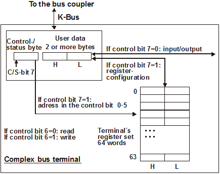

Register communication
Register access via process data exchange
Control byte in register mode (REG=1)
MSB
REG=1
W/R
A5
A4
A3
A2
A1
A0
REG = 0bin: Process data exchange
REG = 1bin: Access to register structure
W/R = 0bin: Read register
W/R = 1bin: Write register
A5..A0 = register address
Addresses A5...A0 can be used to address a total of 64 registers.
Register communication 1:
Register mode control byte
The control or status byte occupies the lowest address of a logical channel. The corresponding register values are located in the following 2 data bytes. (The BK2000 is an exception: here, an unused data byte is inserted after the control or status byte, and the register value is therefore placed on a word boundary).
