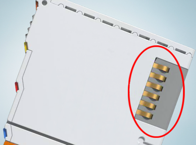

  • Please ensure you are electrostatically discharged and avoid touching the spring contacts (see fig.) of the device directly.

Fig.8: Spring contacts of the Beckhoff I/O components
