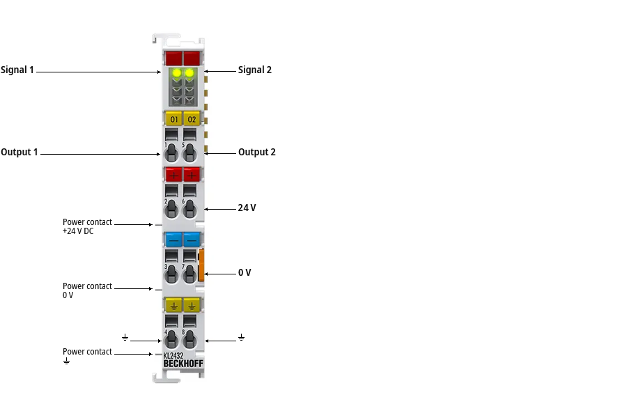

KL2432 - Introduction
The KL2432 digital output terminal connects the binary 24 V DC control signals from the automation device on to the actuators at the process level with electrical isolation. The bus terminal has two channels, whose signal state is displayed by light emitting diodes.
Special properties:
- connection of different load types possible (resistive, inductive, lamp load)
- max. output current of 2 A per channel
- short-circuit proof outputs and reverse polarity protection
