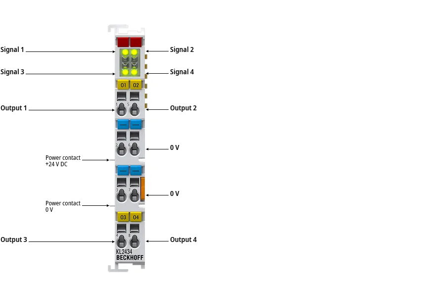

KL2434 - Introduction
The KL2434 digital output terminal connects the binary 24 V DC control signals from the automation device on to the actuators at the process level with electrical isolation. The bus terminal has four channels, whose signal state is displayed by light emitting diodes. Direct connection of four 2-wire actuators is possible because the terminal has four ground connection points.
Special properties:
- connection of different load types possible (resistive, inductive, lamp load)
- max. output current of 2 A per channel
- short-circuit proof outputs and reverse polarity protection
